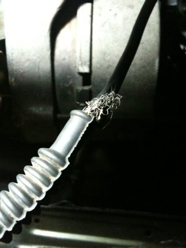

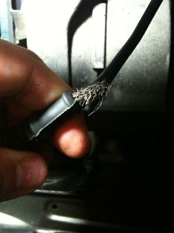

                  Pics of the harness plug where the crank sensor connects too... This is what we are guessing????

                    99% it's the crank sensor.
                    classic sync loss issue, the shield is damaged and causing noisy timing pulses to be sent to the ECU. it can handle some amount of noise but as the RPM climbs it gets worse due to how VR sensors work. ECU loses the RPM, shuts off fuel and you have your mystery rev limiter..

                      The crank sensor was changed to a new one.. the harness plug is the one pictured... Nando
                      Can i splice it and put another one?
                      Or fix this one? Electric tape? LOL

                        you can probably fix it, the frayed part is the shield ground, it needs to be reconnected to the proper pin on the connector. if you pull the boot off you'll probably see where it broke.

                          FIXED IT!!!!!!!!!!!!!!!!!!!!!!!!!!!!!!!!!!!
