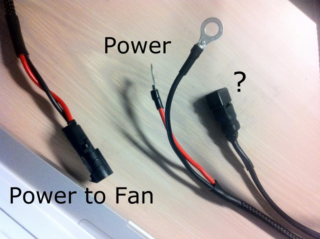

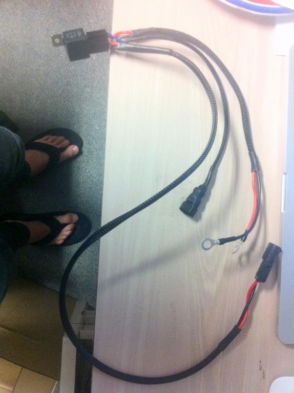

    Hey guys I'm installing my fan soon and I'm looking at the wiring harness and I understand 2 out of the 3 things on the wiring harness but I need to know where this part installs at. In the picture with the question mark over is it the one I need to know where is goes. Can you guys help me?

      Ok I figured out, but is it bad to unplug the Charcoal Canister?
