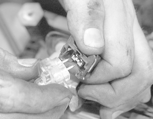

    The connector comes out the same way the round diagnostic connector does. One you unscrew the 2 halves, there's a "nut" that sandwiches the steel pce.

      Thanks. Ya I figured out how to pull it out. The lock ring is underneath where you cant see it and I have never worked on a late model so I was kind of lost for a second. Any other ideas for diagnosis guys?

                Just to clarify guys, your harness issues resulted in a lack of fuel delivery through injectors 2,4, and 6?
                Based on the symptoms it's looking like either excessive fuel from injectors 2,4, and 6 or somehow incorrect spark timing for the same holes. The dead holes have spark and fuel as well as compression!

                      Maybe. If Wishno had a noid light for a Bosch FI harness he could see this happening but he doesn't.

                            Ahh is that what you were talking about? Looks like a worthwhile investment.
                            • Ryann
                              • 3350
                              Yes, they're really handy. It's just an LED that illuminates when it gets a signal from the DME. When plugged in it should pulse like the injector would.
                              I suspect it will remain illuminated like LJ851 suggested.
