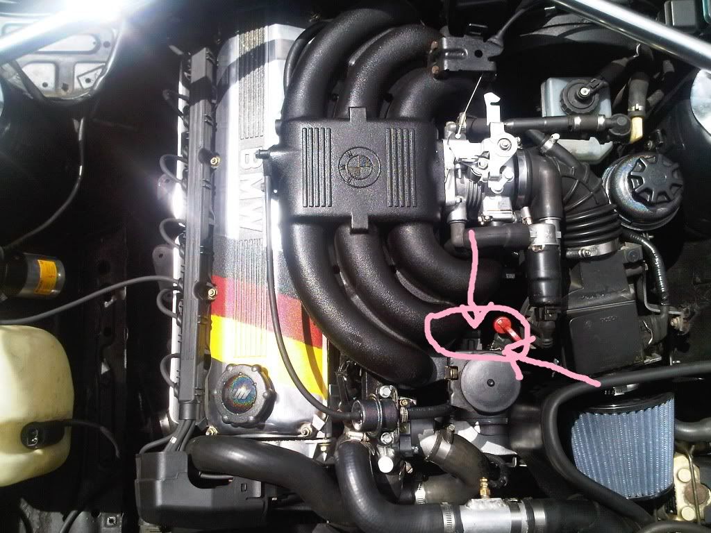

    so this was a really convoluted process. i bought the car with a snapped belt. changed the head, new belt. etc. i didnt put the intake manifold on correctly and had some serious vacuum leaks. it ran though, just terribly.
    so i pulled the manifold back off and installed it correctly. even with a brand new fuel pump. now.. now im not getting spark. i've swapped the spark pulse sensor and the cps back and forth a million times. i've tested the cps. i've swapped the coil. and i've tested another dme. swapped the main relay too.
    im at a loss here.
    2 friends of mine (independently) think something, unrelated, just broke in the mean time. a relay or what not. all the fuses look good. i've tapped on all the relays to see if that helps. pulled the plugs, soaked in gas. pulled the line to the fuel rail, i got soaked in gas. i know i have gas. i've pulled the plug, connected to the an ignition wire and cranked and nothing..
    the coil is not getting any power during cranking either.
    input appreciated.
