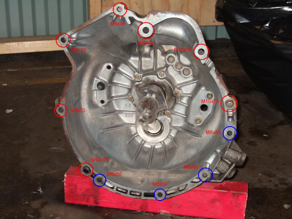

    After finally getting my car running, It will not hold coolant! I suspect a broken Freeze Plug after the cold winter. I searched and found little on either freeze plug location or how to install a new one.
    I thought the leak may be behind the starter. After pulling the starter I still cant find it.
    Looking over the tranny I see water leaking to the side of the top bellhousing bolt. The water leaks to the right in this image.
    Do you know of a D.I.Y. or have any information to help me finish this damn car?
