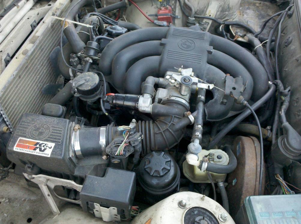

        Here's the OP's engine bay:
        It's definitely running the i wiring, sensors, and ICV. It's got the i intake manifold and throttle body but it's got the e valve cover. Most likely it's a 2.5 with the wrong valve cover but one will not know for sure without checking the numbers as suggested above.

            There's some mismatched parts on that engine so chances are it's not just a 1990 M20B25. What does the head casting say in between cylinder 1 and 2 plug wires? "Set up for turbo" typically just means it's an ETA with an i head, which might explain the ETA valve cover and brace.
            88 M3 - LACHSSILBER/SCHWARZE
            • Old-Skool-Kid
              • 29
              The only number I can see is "15" between the front two intake ports. and the block has "2.7" stamped on it.
