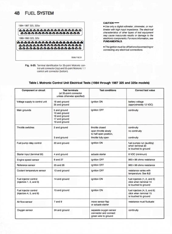

          "On models with 6-cylinder engine, there should battery
          voltage between the red /white wire and ground when the
          ignition is on. If no faults are found, check for contin uity between
          the connector's ground wire (brown wire with colored
          stripe) and the control unit. If no wiring faults can be found, the
          control unit may be faulty. See 5.4 Electrical Tests (L-Jetronic)
          or 6.4 Electrical Tests (Motronic) for control unit terminal
          identification and· additional electrical tests."
          That is the injector electrical test, but I am not understanding it

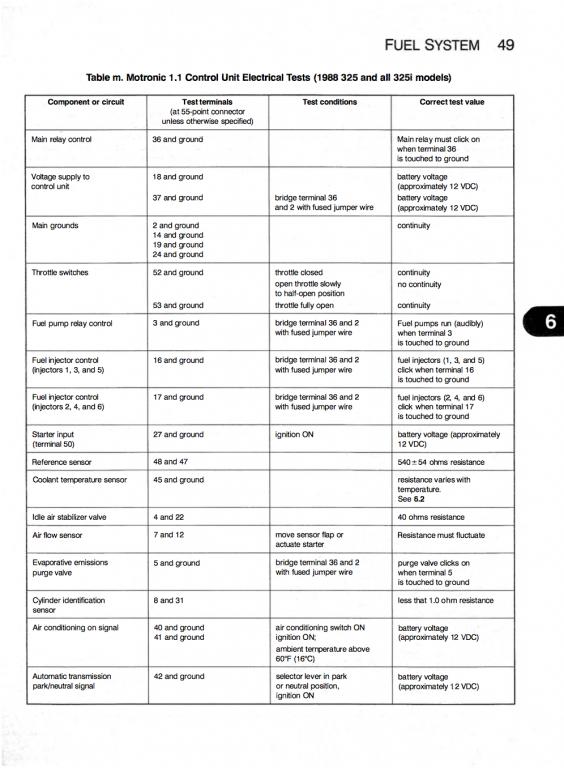

              you only need 3 things to have the car fire. air, fuel and a spark. so you are missing one or more. if you ground a spark plug and see a spark then if prob means that you aren't getting fuel.
              i would first test from the ECU that the injectors work. in the bentley there is a test for the injectors to ground them and they will "click" meaning they are opening. They spray in sets of 3, so make sure you are hearing the click for them.
              if you are then I would check the CPS and if that checks out then perhaps the ECU needs to be replaced.
              that all being said. when you changed the injectors out and back in you obviously lost all the fuel pressure. with the car in the "on" position before you crank, bridge the fuel relay to turn on the fuel pump. let it run for 30 seconds or more for the pressure to build up, you might even hear a whooshing sound which would be the fuel pushing the extra air in the lines.
              try all that then let me know

                The test in the bentley I copied and pasted in above, but I dont understand it. Can anybody please tell me how to the test?

                  yea i read it and didnt understand it either. i dont know what section that is from so I dont know what red and white wire is
                  this is the test i was talking about:
