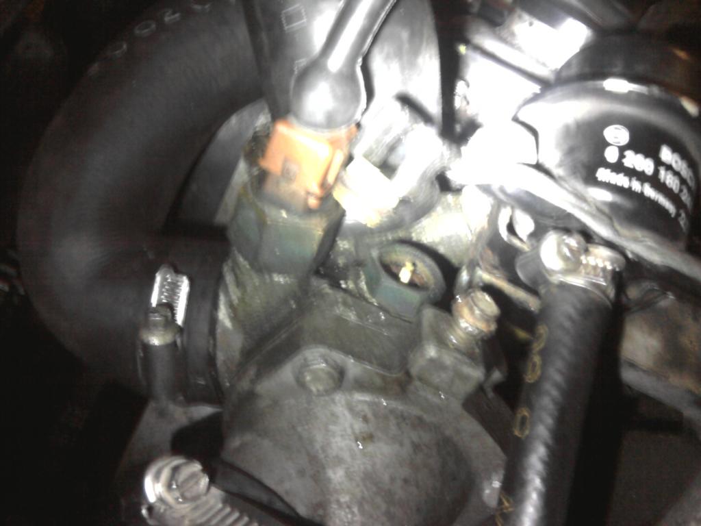

          so injectors are not fireing.. also this sensor is brike in half i shoved it back on but idk mayne this is why does any1 know what this sensor is and if it will effact the injectors?

            The blue sensor(looks broken off in the photo) is the ECT sensor. I believe the car may run without it, but definitely replace that sensor as its necessary for the ecu to alter air/fuel ratios. It should be a 19mm open end wrench to remove it, be prepared to lose some coolant.
            The brown one is for the gauge on the instrument cluster. THe engine WILL run without this sensor. Definitely replace the blue/broken off sensor.

                Something looks wrong. An ETA should have four sensors in the top of the thermostat housing. But I can only see two.
                I'd have to look up the wire colors, but that running across the upper timing cover could be for the oil pressure sensor, which is mounted just above the pan on the right side of the engine.

                  there is 4, the other two are hiding behind the fpr took a close up with my shitty phone camera, and the green wire is comming out of the same part of the harness as the injectors are on, but yeah that makes sense..
