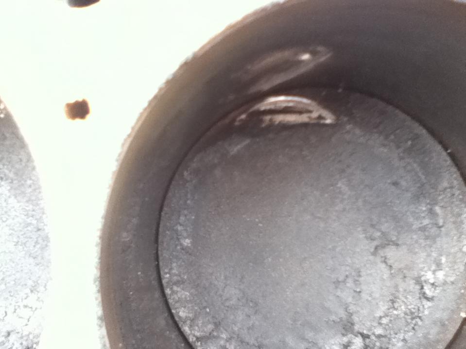

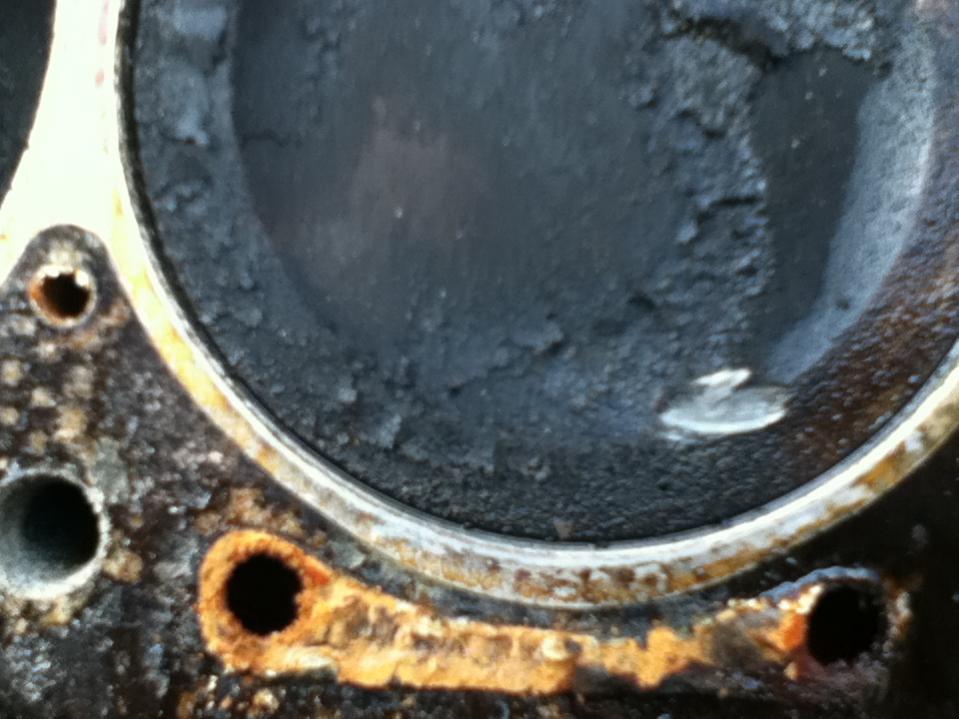

                      • JGE30
                        • 104
                        Should i run the pistons if they have this big smash mark :pClick image for larger version
                        #1 has a little ding
                        • Ceeker
                          • Sep 2009
                          • 2821
                          should be fine..
