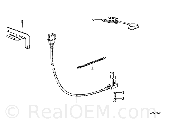

    4/87 build 325is.
    Is it just me, or is there no crank/position sensor listed on Pelican Parts for my car?
    The only one listed for an M20B25 car says for build dates after 9/87. Then there is a "Timing Sensor for Motronic Ignition (Front of Engine), 325/e/es/i/is/iC/iX (through 8/87" listed but it doesn't look like a CPS at all, doesn't even have the mounting hole.
    RealOEM says the PN is 12141720852, shown as #1 here:
    But that PN on pelican parts brings up the same sensor that specifies it is for cars made AFTER 9/87.
    Anyone have any experience with this?

    It's labeled wrong on Pelican parts. It's not supposed to have a before or after date.
    They're either mounted in the trans, or on the front of the motor. Of which the 325iS never had a trans mounted CPS.
    12141720852 is the CPS you want.
    So yes, it's just you... AND pelican parts for labeling it incorrectly.

      Front mounted on the passenger side by one 6 or 7mm allen screw. Then you have to fish the wiring from under the plastic cover that's clipped to the timing cover. Be careful not to break it, it's probably brittle. I believe it slides up. The connector terminates under the diagnostic connector.
