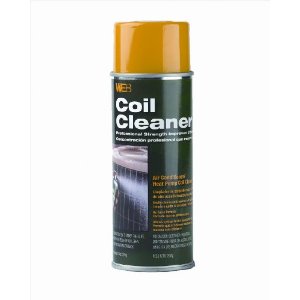

                    I've read enough threads about cooling etc and have never once seen mentioned something that I try to do routinely and absolutely do whenever my radiator is out. Go to Home Depot and spend $5 on a can of Coil Cleaner... yes, thats what its called. You use it on the outside of your radiator and while you are at it do your oil cooler and condenser. If you can shop at an HVAC supply house they will sell you a 1 qt spray bottle for $10-12 which will last eons.
                    Cleaning coils is recommended annually for your home AC which does not move down the road at 50mph gathering bugs and other crap so think about the insulating layer you have on your radiator fins whose sole purpose in life is to dissipate heat.
                    Last time I did my house AC the air coming out of the registers was dramatically cooler and my electric bill dropped big time.
                    Imagine what it can do for your car.
