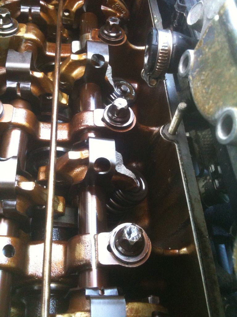

        Pull the head before you try to decide anything, or at very least the valve cover to inspect damage. If more than just the rockers are damaged expect to need an engine as it takes some serious piston-valve contact to destroy the rocker shadt retainers.
        Example, my newest car had a blown m20b25 timing belt
        note the 1st and 3rd head bolt platforms are broken over the rockers
        Again, but a complete picture. (sorry the picture is upside down) note how many broken rockers and parts of the head itself on the intake side
        The result on the bottom end, every piston was damaged almost identically.
        Good luck!

                The car from those pictures was picked up with the motor already blown as a project car, the sticker on the shock tower says belt was replaced at 213,000km. The car now has 214,000. When I pulled off the timing covers I found the tensioner locked in the fully released position so basically the P/O fucked up. The repair is not actually that bad if you pay close attention to the steps and a bentley is a huge help for first time
