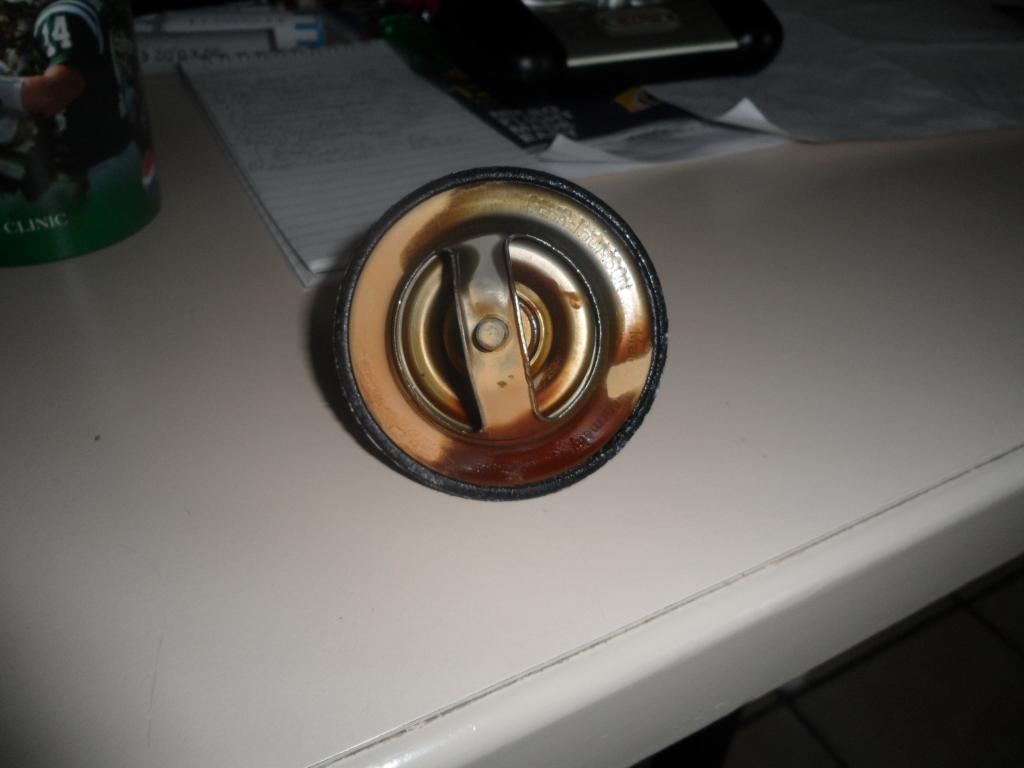

    So I've been doing the routine maintenance on my car and have fixed a number of little things. I changed out the coolant to the BMW type with distilled water as the old coolant was either VERY old Dexcool or extremely ancient regular stuff as it was a sewage water orangey-brown. I flushed the system and bleed it as well. Driving around it usually sits at around the 1/2 mark to about a 1/4 below half. Occasionally if I am sitting it will go maybe a hair past the 1/2 mark, but always comes down when I start moving again.Today when I got home and was idling in the garage for a min the temp gauge started creeping up and got to the 3/4 mark. I figured there was still air in the so I bled it again, but there was straight coolant coming out. I had a new T-stat to put in anyway, so I broke it apart and changed it. I found some silicate deposits in the T-stat housing and the T-stat itself looked burnt( pics attached). What could cause a T-stat to become burned looking that? Should I be worried? I'll see how she does driving to work today and post up later, but any advice would be greatly appreciated...

      Seal looks like it was crumbling. Antifreeze becomes acidic as it gets old so it tends to eat old stuff. As you said the coolant did not look like it had the proper mix nor type.
      Might not have been distilled water either. Have you checked your fan clutch?
