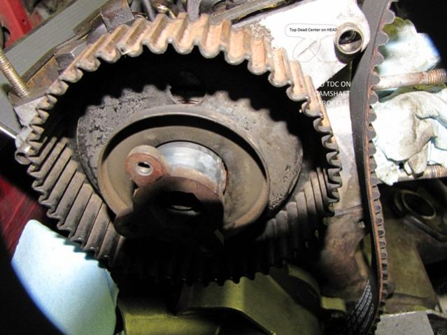

    My camshaft sprocket does not have the notch in order to align it with the TDC mark on the head.

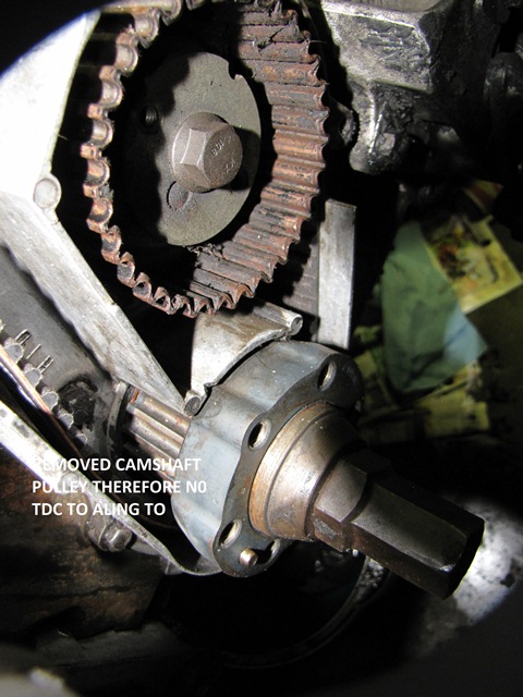

    I'm stuck since i also took out the crankshaft pulley and the lower timing belt cover so i cannot locate the TDC.
    Should i just reinstalled everything and then try to find the TDC for the crankshaft and camshaft.

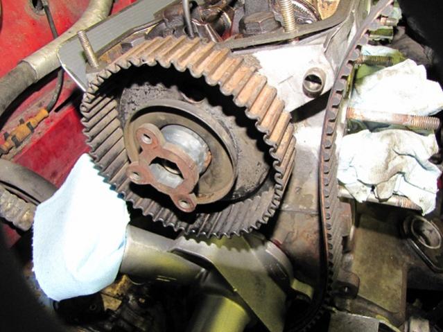

    Here it is the camshaft sprocket and camshaft area.
    Clean all that junk off and there should be an arrow
      On the camshaft or the crankshaft?
        camshaft sprocket
          It's on the cam gear. There is either an arrow on the inner section of the gear or a line below one of the teeth that will line up with the line on the head. If you have a bentley manual it has pictures of each, there is a PDF of the manual in the DIY section i believe.

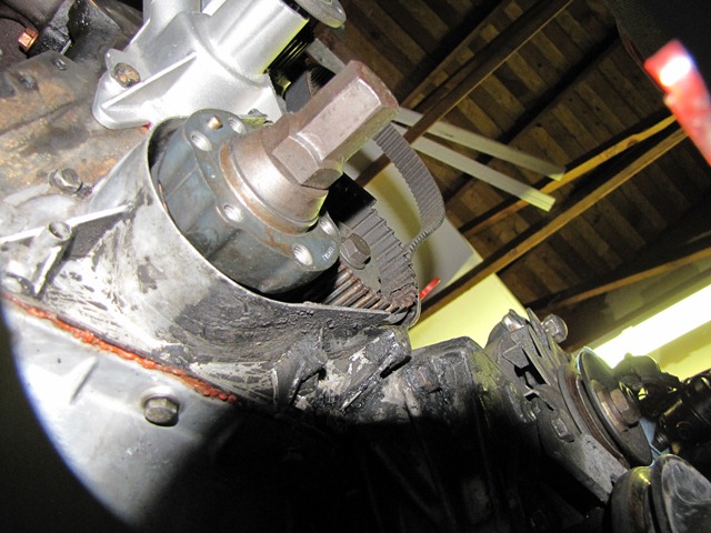

              I have never see a cam gear like yours and therefore have no experience finding TDC for it, however for the crankshaft you can see a small line on the section where the vibration dampener bolts to(on the last photo you attached) which when lined up with the small notch(can be seen in the 3rd picture you attached) means that the crankshaft is at TDC.
              Hope that helps
                This sounds right, but you should replace the camshaft sprocket with a cast one as ones like yours have been known to disintegrate. They also have a better mark for TDC. There's a thread somewhere with pictures of what can happen.

                        Also you have the old style stamped steel timing sprocket which is known to explode occasionally. I would change to a solid metal one while you're in there.
