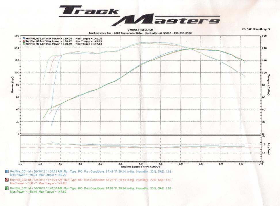

    Finished my 327i a couple weeks ago. Used a EU 323i, 731 head with the 323i cam. Head was recently rebuilt. so it was checked for warpage and bolted onto the 325e block. The rest of the parts followed the 1.3 Motronic upgrade here in M20 section, super easy. First AutoX, I had a tough time finding any traction, due to the huge jump in power. Everywhere I could flat foot, no longer possible due to traction problems. The 1st to 2nd shifts are so sweet with the 3.73 LSD, but I now have to get used to a transformed machine. Good stuff. 139hp/149ft lbs of torque.

    Yes making me happy currently gathering parts for this. Any advice on anything? How big was the difference from the eta?

      thanks for the info. which intake manifold/TB did you used?

        The manifold/TB/cps from a '90 325i. Using the 173 ECU and eBay chip, the wiring harness was from a '88 i. Plug and play all the way. Too simple. The difference from the eta is night and day. Old eta never squatted down and lifted its nose before on the 1st to 2nd shift.

            I'm donig an 885 head onto an 86 325e bottom end. Thinking of building the head up some, to get ~ 200HP @ crank ideally.

              I am most pleased. This is the first time anyone has done a swap like this and bothered to post actual dyno results. Thanks and subscribed!

                  After planning this conversion for a year, I just had to see what the final results were. Wish a baseline 325e pull had happened, but from what I can find, looks like about 75-80 rwp? Is there a common formula for our cars to roughly determine crank output from rwp? I guessed seat of pants, a 60hp increase over the eta. M

                            what diff are you running? I have a similar set up. 86 eta block with a rebuilt/decked 885 head. 89 1.3 harness 173 w/ ebay alpina b3 chip copy. My only downfall is im still running the eta exhaust and the 2.93. Over all the car still pulls great and if anything its still just as fast as or faster than a stock b25.
