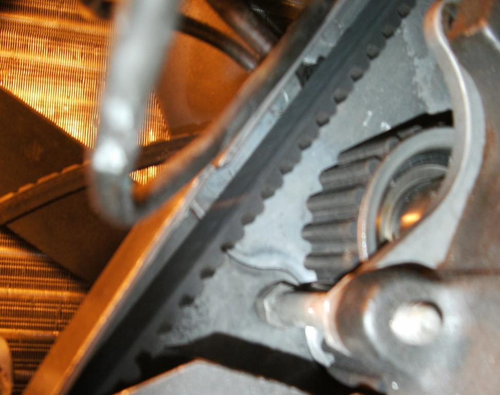

                  Remove intake/AFM, alternator bracket, and rubber cover, Voila.
                  Dude, your bolt that holds the tentioner and the cover is on backwards. the 12mm side goes into the block and the larger flat side goes out to hold the cover...

                    Discovered nothing yet. I may have time tonight to look. If not tomorrow morning. I will inspect it first. Hopefully find a belt in good shape. We shall see. I will update then.
                    As for the bolt/stud in the pic, Cabriolet is right, it's backwards. I will use that window to inspect though.
