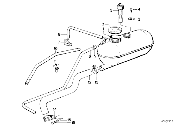

Expansion tank leveling switch - where to connect?
  • amcink
    • 788
    The leveling switch at the expansion tank; i do not find the electrical female part to connect to. Item #5 on diagram

    It's part of the front harness that has the horns, AC and lights in it-
    you may find 2 individual connectors, as they clipped into a holder that made a
    2- pin connector- take a look at the ETM for the wire colors...
