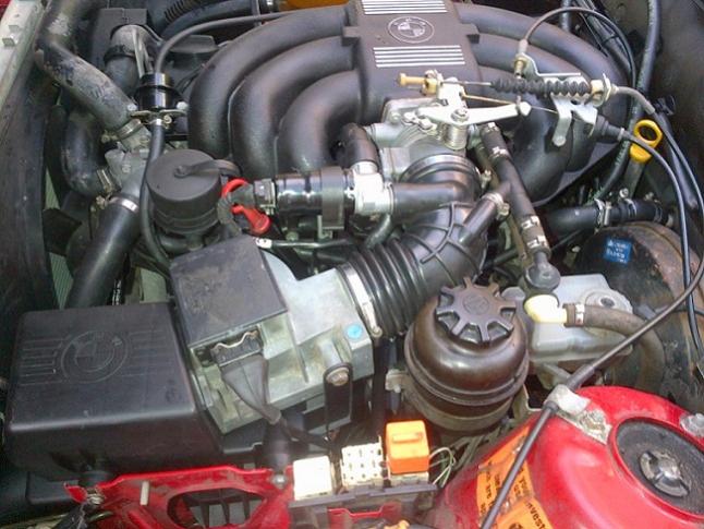

      The vacuum line is new as are all intake manifold seals, fuel lines etc. I'll try swapping FPR's with my 89 and see if the problem follows it. In the meantime here is some eye candy.

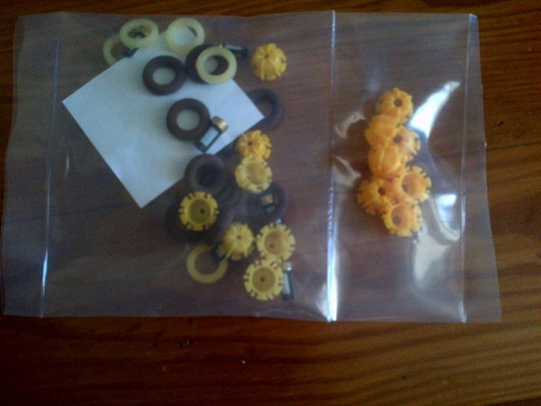

          I can also swap the CPS if the FRP swap doesnt reveal the problem. As for the injectors, they got the royal treatment from new filters & pintle caps to repainted bodies. I dont think even a bad one would be causing this problem.
