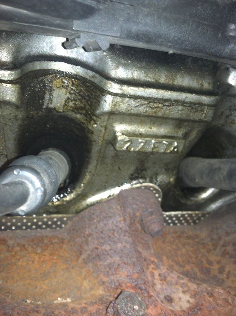

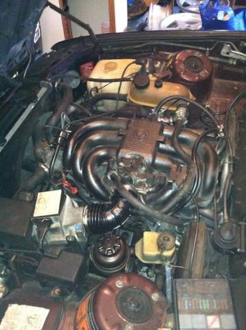

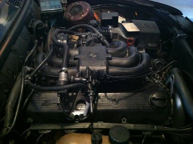

                  Post pics of the motor.

                        you dont know the previous owner lol. he had no where near enough intelligence to do something like that.
                        heres the head though.
