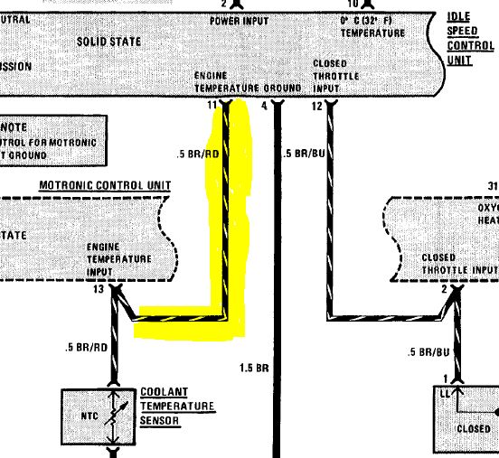

              • mrgraphics
                • 221
                #37
                Checked the wiring - it's good. I have zero resistance to ground on the brown wire of the connector, and the Brown/red wire to the ECU has .3 resistance on a scale of 0-200 ohms. So that is not enough to throw off the reading of the sensor.
                Yet another new sensor in and it still behaves badly.
                It idles fine, and runs ok, but there is just no power and it sometimes feels like the transmission is slipping, and the discussed power bogging. Yet, I know the transmission is good because it runs strong without the sensor.
                Looking at the wiring schematics, I see that there is also a brown/red wire that goes to the idle speed control unit. Could this be what is causing the issue . . . not the DME, but this box?
