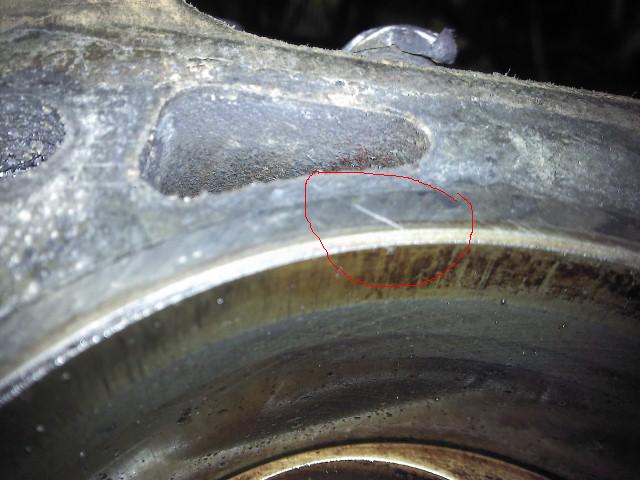

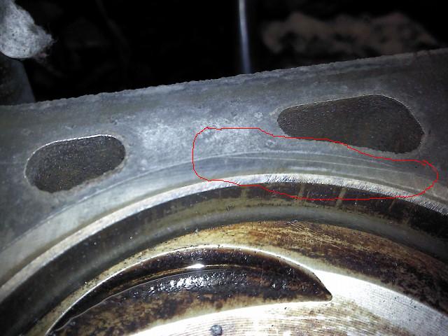

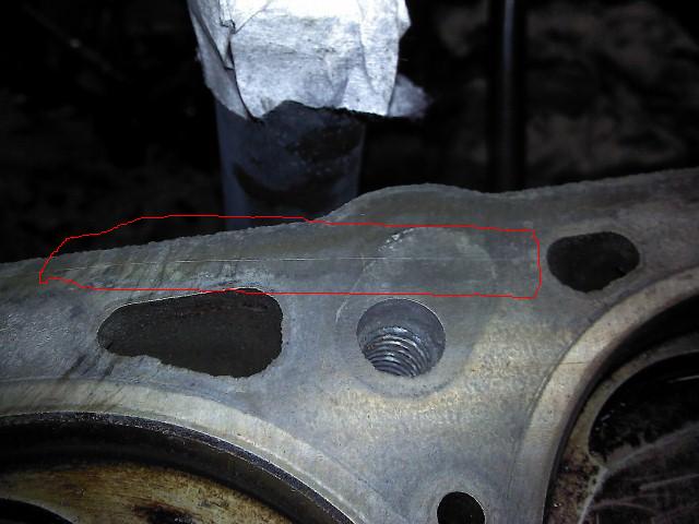

                  Its more of a scratch then a flake, but here are some pics

                    you're fine. you need to clean the block a lot lot more. and that scratch will come out as u do that.

                      You should hit that with an angled die-grinder and non-abrasive cleaning pad anyway.
