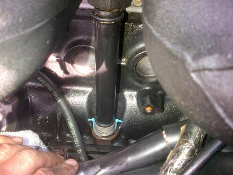

                Seriously ? The tube is the only way for oil to get back to the pan after lubricating the valve train and the channel that passes through the intake manifold is isolated from the runners.
                As for the install..

                  Thanks for the pic!
