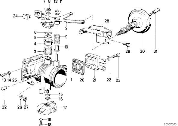

      I have, or should I say had an '85 323i. I have ditched the motor in favour of a B25. I can't advise you what is what, however whilst trawling around on RealOEM I found this.
Name:	323i throttle Dia.png
      P/N 30 CONTROL BOX 1 13541289039 $231.96
      I think is the part your chasing. I could well be wrong and as I said I don't have the engine anymore for reference. It uses vacuum to control the throttle springs/butterfly valve.
      Hope this helps

          Thanks very much mate but I know the name of what I'm after and where to find it on RealOEM, just can't find it out in my garage! Thanks for the input though.
