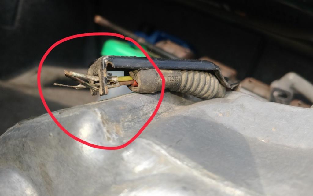

                            Originally posted by AndrewBird
                            Get the part number from here:
                            http://www.realoem.com/bmw/showparts...12&hg=12&fg=31
                            And order one from the dealer. Should be #3 I believe.
                            This is the female part.
                            The male part is being a pain in the ass to find.
                            Mine broke too. Click image for larger version
