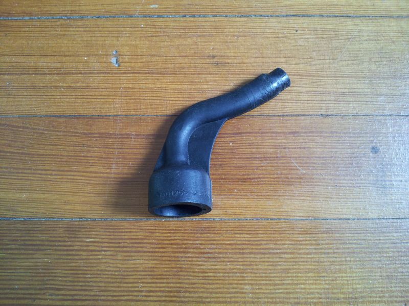

    It goes from the charcoal canister to the throttle body. I've checked realoem but couldn't find it.
    A PO thought it was a good idea to wrap this cracked one with electrical tape so I'd like to replace it.

    go get a same size diameter vacuum hoses and cut to size.

      I would prefer to replace with the factory part but that is certainly an option.

        I'm afraid that is part of the emissions valve it's attached to. I've also tried to find a replacement.

          unfortunately that hose is no longer available, I would do as "e30mpg" said and get a piece of vacuum hose and cut to fit.

            Looks like that is my only option at this point. Thanks for the help guys.

              Nothing wrong with using generic hose to replace it. It will function just as well.
