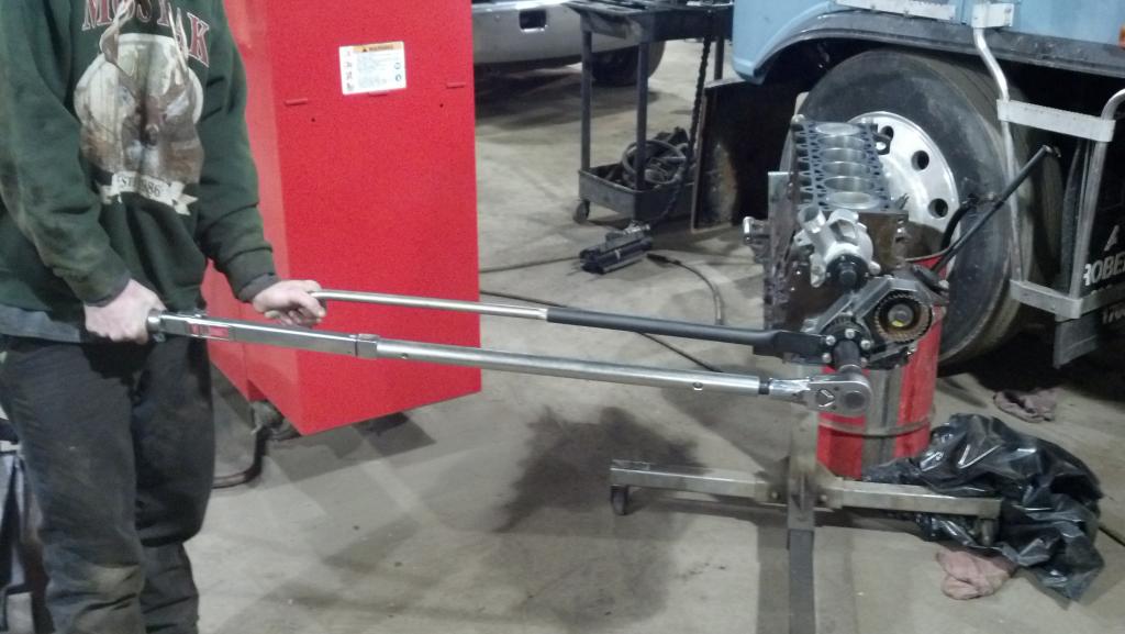

          Changing the cam seal and oring and the IM gear seal are a good best practice and fall under the "low hanging fruit" dept of the while-you-are-in-there school (in other words change them)
          The crank seal is another animal though since its torqued to 300lbs. It also generally calls for the crank holding tool and a front pan gasket mod/repair since the lower timing cover (that the seal presses in to) mounts to the pan.
          I would say that unless you have an obvious leak or an abundance of ambition and based on your guidelines, you may want to leave that one alone.

              It's not a lot of work if you know what your doing and you have the tools. However, if you don't know what your doing and you don't have the tools (something to hold the crank still and a torque wrench capable of 300 lb ft of torque), you may be opening a can of worms you don't want to eat.

                x2^^ just did this. what a PITA.
