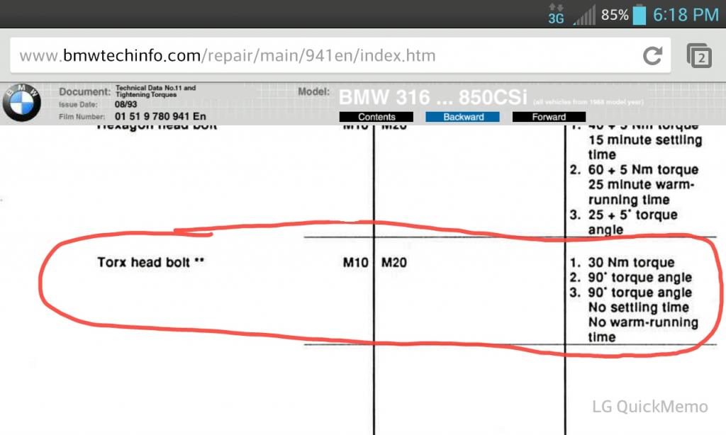

I just finished putting the head back on my eta. Smoke and oil is leaking from the gasket at the exhaust side. I must have done something wrong. What should i do next?
Here is the run down of the job.
Head has been resurfaced.
Block is cleaned.
Bmw oem headgasket.
Valve is adjusted.
Torqued a 22lb, then 90(1/4 turn) and another 90 according to manual.
VR torx bolts.
After i see smoke and oil I run another sequence at 10 degree but still only getting 65lbs. I believed it should be 80lbs.
Should i do another 10 degree increament until i get 80lbs or i need new gasket since it already have oil on it?
Block is cleaned.
Bmw oem headgasket.
Valve is adjusted.
VR torx bolts.
