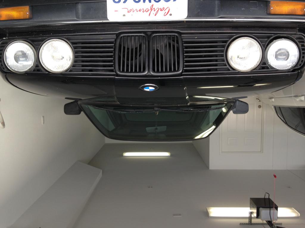

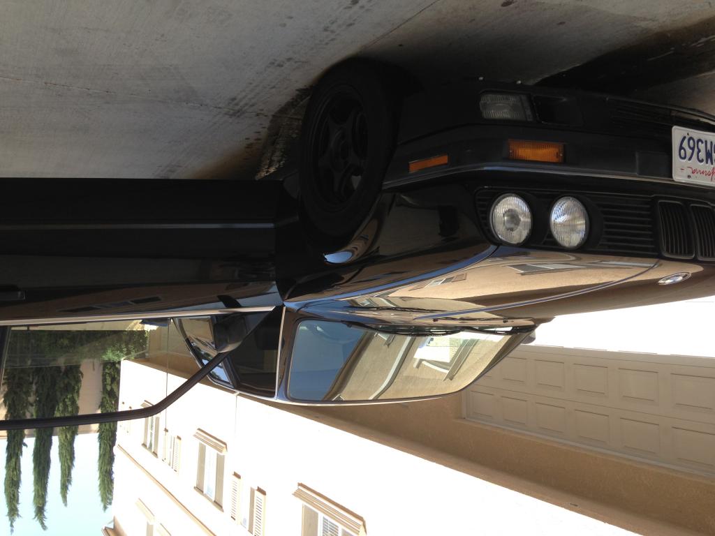

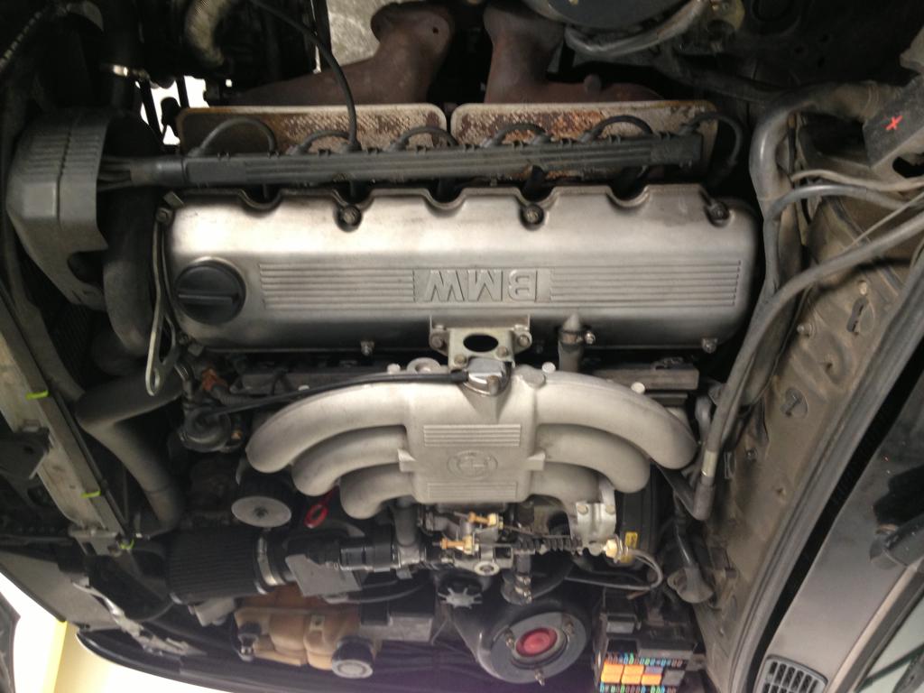

          Took some pics to give everyone a visual;
