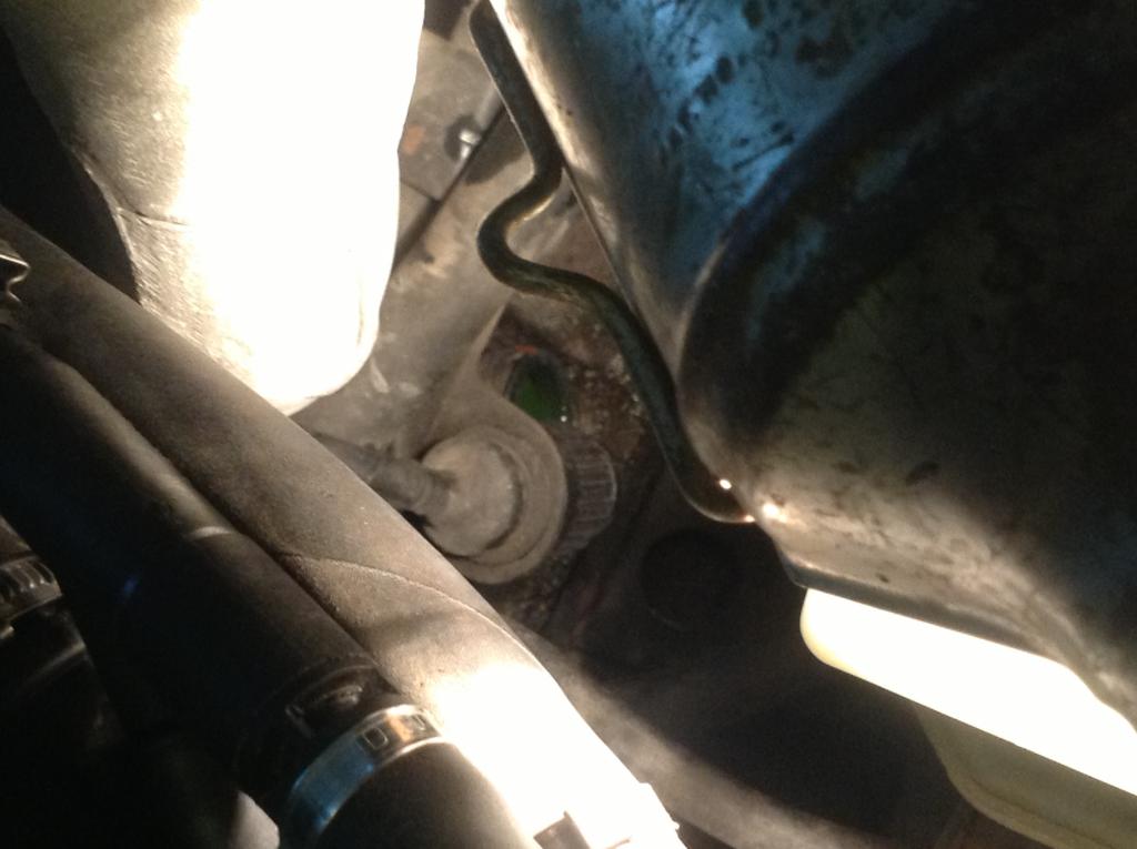

                  WTF? pull the boot off the bottom of C191 and its filled with green coolant?

                    WOO! progress i took the Boot off and every time i touch the wires underthere if my fingers are wet it shorts im guessing and the engine dies.

                      Maybe jumped the gun it dies regardless of if i touch the wires but i think this might be the culprit.

                          So here is where im at i repaired the C191 plug and the car will idle for 10-20 seconds then die abruptly. i can get the car to run for a good amount of time if i keep my foot on the gas and as soon as i let off it dies. signs of a bad fuel pump?

                              How did you repair the c191? My friend had one where we cleaned the pins and lubed it with dielectric grease, and no changes. It turns out, on the female connector, the wires to the female pins were not even connected, some dangling on.
                              There is a diy of cuttuing the whole harness out, soldering custom male female individual prongs, and then calling it a day. One of the wires on the male side of the harness (I think) goes to literally nothing just as a heads up.
