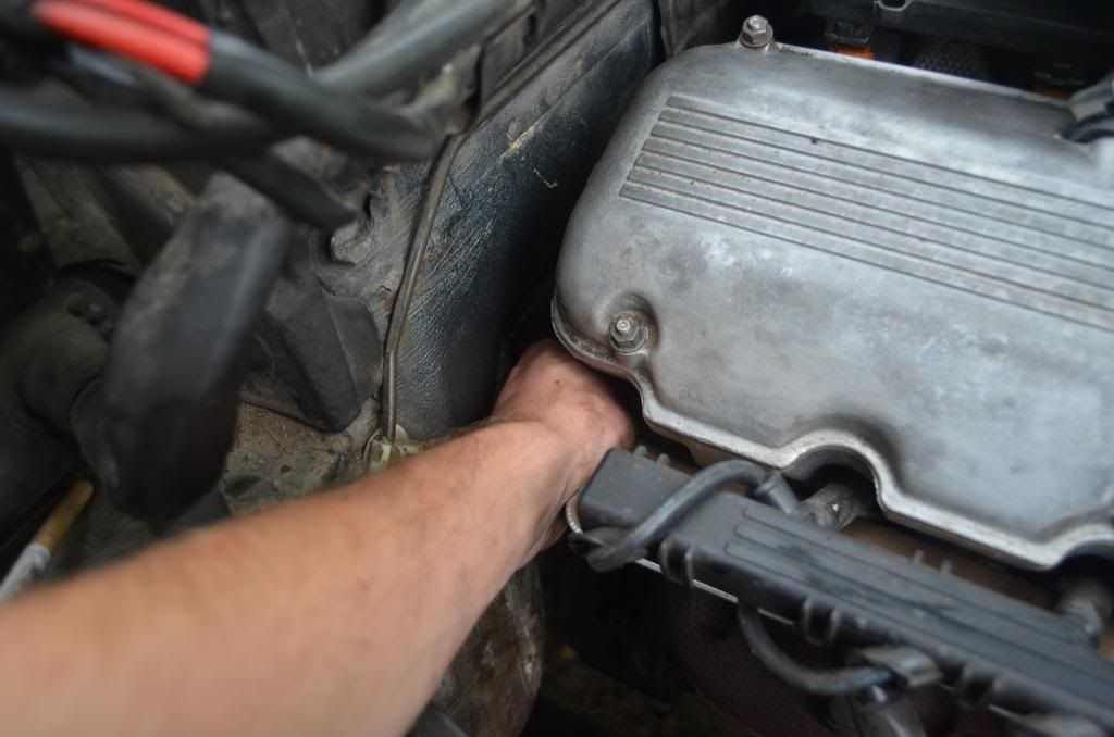

              For the record, not fun. This was after I dropped the subframe 3+ inches.

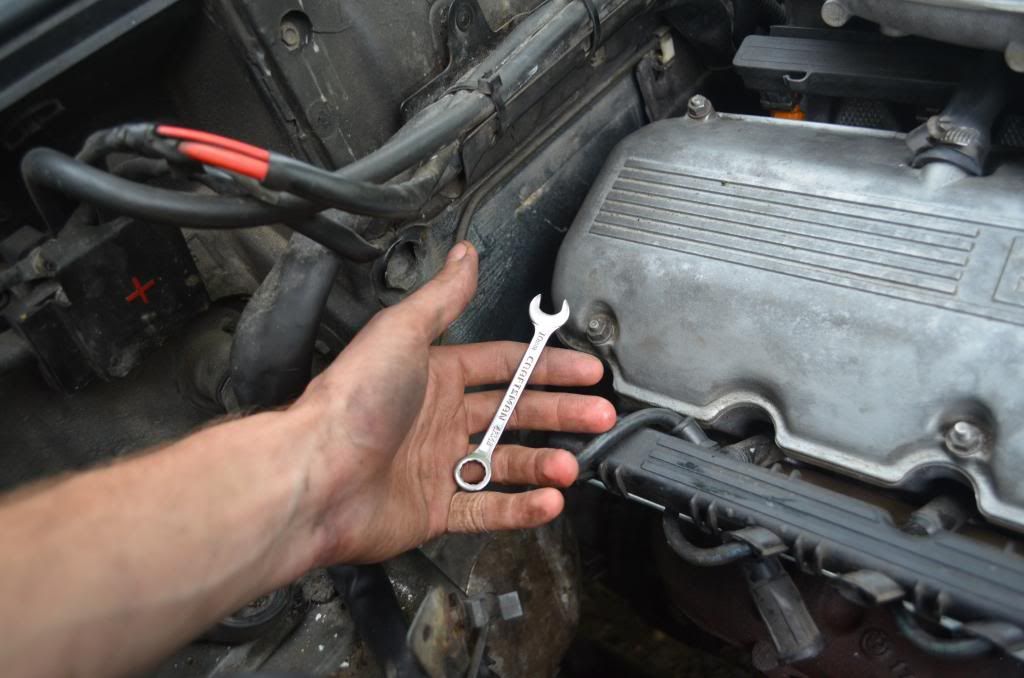

              The only tool ended up being able to use:

                  I'd recommend investing on a ratcheting 10mm wrench as well. ;)
                    Ha. My dad had gotten home as I finally got a bolt threaded and asked me why I didn't go to the store and get a ratcheting wrench. I told him it was because my car wasn't running.
                    TL;DR: Yes, all I could think about was how heavenly a ratcheting wrench must be.
