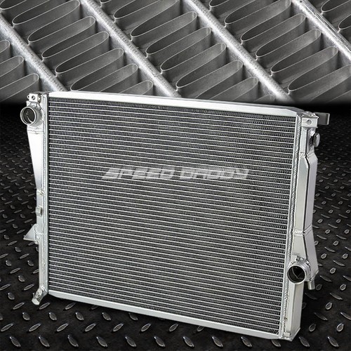

                    I dont think the radiator was ever replaced, and was told that it was leaking when I took it in to a bmw shop, but they wanted 600 dollars to replace the radiator, and said the radiator costs 300. Thats an easy decision for me to say fuck that and do it myself, but the leak stopped on its own so I just let it go.
                    INSTAGRAM @ merlow_
                      From my own research, no personal experience yet, but I hear the ebay aluminum ones are great stock replacements, and at ~$100 you can't go too wrong
                        Do you have a link to a specific one?
                          I've heard good things about the cxracing one:
                          However, I might jump on a z3m radiator as I might go to track days and the z3m is a direct drop in with 3 cores
                          But this is all based off research alone, someone else can jump in here and give some experienced reviews.
                          My Transaction Feedback
                          My "build" thread
                          BUY MY CAR!!
                            so if going with a replacement, the z3m is considered upgraded? What are the upsides and downsides to running one of these?
                            INSTAGRAM @ merlow_
                              Based a little on research and a little on intuition, here's my somewhat developed opinion:
                              OEM: Perfect fit, all the cooling you could ever need for street, track, etc. Plastic will likely rot out after about 20 years (...), and may not have the cooling needed for a super hot day, or a track car making some serious power. And supposedly the thermal shock or something on the track isn't good for the plastic. So aluminum might be better here. Oh and this is crazy expensive.
                              Ebay aluminum: Aluminum won't dry rot like plastic, can handle rapid temperature changes seen on track better than plastic, really no added cooling though, much lower cost, fitment can be so-so, but still very useable, as tolerances don't need to be tight for fitment. I hear a guy had to bent the barb for the tube that goes to the reservoir. Oh and maybe the welds aren't as high of quality?
                              Ebay aluminum z3m: 3 cores means more cooling capacity, can handle track cars making serious power probably? A little more expensive and it might not be necessary. I think the only downside to the z3m over the stock would just be the extra cost for efficiency that might not be needed.
                              And once again, my intent isn't to spread misinformation, I'd talk to people with more first hand experience rather than base a purchase off my own research
