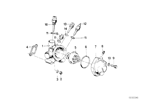

    Can anyone run through the functions of the 4 different temp sensors on the '86 eta please? Did they really need four to do the job?
    From some searching I understand one is just for the cluster gauge, one goes to ECU, one goes to cold start switch...?? I may be off already....
    So, we're talking about items 12, 13, 15, & 16 on the diagram. The description from realOEM says:
    12 - coolant sensor
    13 - temp switch, water
    15 - temp switch
    16 - temperature-time switch (the thermo-time switch, correct?)
    What does each do, does the Bentley list an electrical test for each, and is it worth just changing them all out at 175k? The parts sources sometimes contradict each other, or just list them by color.

    As Far as I Remember , My Car Has Only 12 and 13 Switches .
    Which are 1 For The Coolant Temp ( Cold Start )
    and The Other one if for the cluster Reads .
    Haven't Seen other models .
    My Engine is a motronic late model .

        Same setup as what I have,
        16=ecu temp switch
        15=thermo switch (45c I believe, I have to look at mine)
        13=idle control temp sensor
        12=cluster temp Guage.
