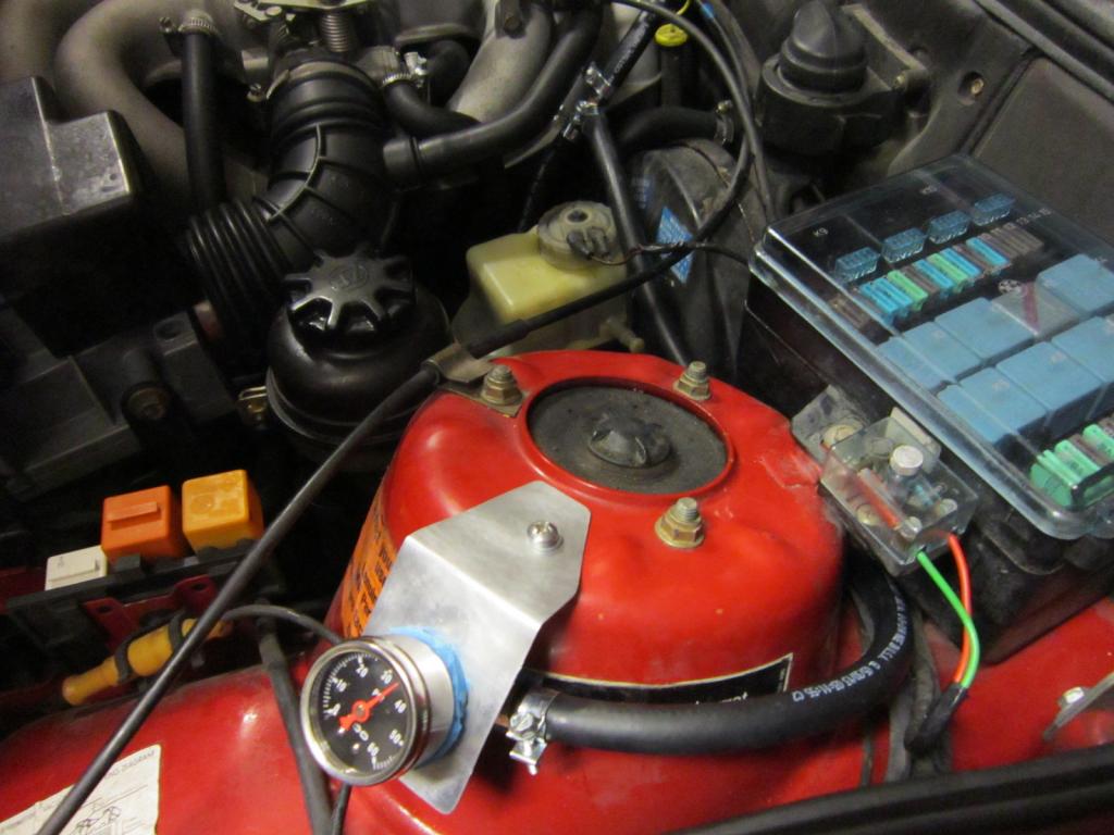

                          As we said earlier, we have a new lift pump installed. We put a fuel pressure gauge on the driver's side shock tower. It reads about 39 psi when jumping the relay to run the pumps. Same psi at start-up. It held pressure for several weeks, say 35 psi for a week or two, then slowly dropped off.
                          The fuel pressure regulator was a working used one from a r3v member. I assume it's good.

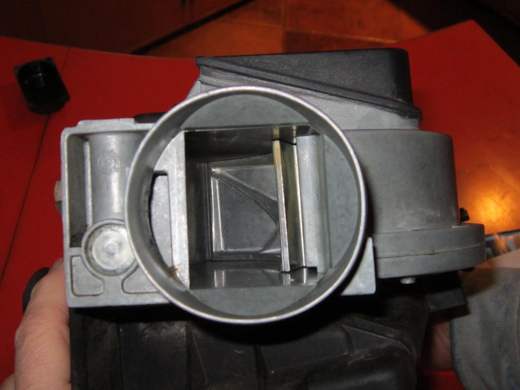

                          I pulled the AFM to clean and test. As part of that process I learned about member Gregs///M and his rebuilding service, and the very limited testing you can do with a DMM. We did check the temp sensor and got normal resistance readings.
                          The AFM flap is quiet and smooth. (Should we hear the wiper arm dragging on the track at all?)

                          Since we figure the ICV needs to be replaced anyway, what the hell, let's fiddle with the adjustment screw! I turned up to 2 turns out, and the cycling became faster. From zero, I went 2 turns in, and the cycling stopped. Idle still at 1200. Interesting - what does that mean?
                          At about 20 minutes, it just shut off. It's like turning the key off, no stumble or anything, it just shuts off. Wouldn't restart. Fuel pressure stayed at 36-ish. I wasn't watching it when it died.

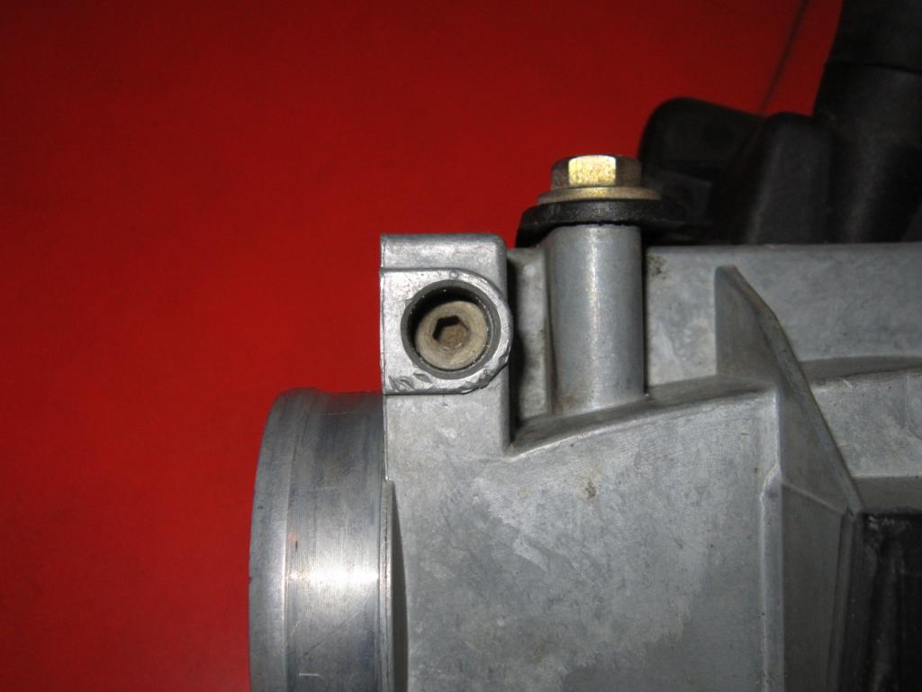

                          I also have some AFM questions - the seal / plug on the adjustment screw is gone. Does it seem likely that someone has been messing with it, trying to make it idle correctly? I checked the tension on the screw and it's loose - no resistance at all. I turned it a couple of turns while idling with no change. Set it back where it was.
