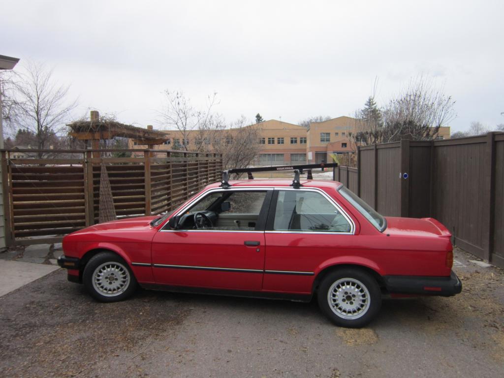

                      Update -
                      We finished installing the suspension, and it's beginning to warm up outside so we can get some work done.
                      The car ran perfectly for a week. Like a new car. The smoothest idle, everything fine. Drove it 20 miles one day - perfect.
                      BUT, we never really fixed the problems, so we don't trust it yet.
                      Today we were taking it in for an alignment, and it wouldn't start. Same issue - black smoke, sputtering, barely idles. He took off the oil cap, and there was no idle change - doesn't that tell us something?
                      I'm thinking there's an intermittent big air leak somewhere -
                      Brake booster / vac check valve / o-ring at master cylinder?
                      Charcoal canister system?
                      Intake manifold gasket? (PO had a new head put on 5000 mi ago)
                      Bad o2 sensor?? (Brand new Bosch)
                      Would a cold start valve just decide to spray fuel when it's not supposed to? We replaced the temp-time switch.
                      We're taking it in for a "professional" smoke test Monday - maybe we're missing something. But if it's running well, how will they find the vac leak?!
                      To help others, the ICV was a big fix for idle problems, as well as a fuel pressure regulator and Air Flow Meter. We clearly had several things going on at once, and a lack of maintenance by POs.
