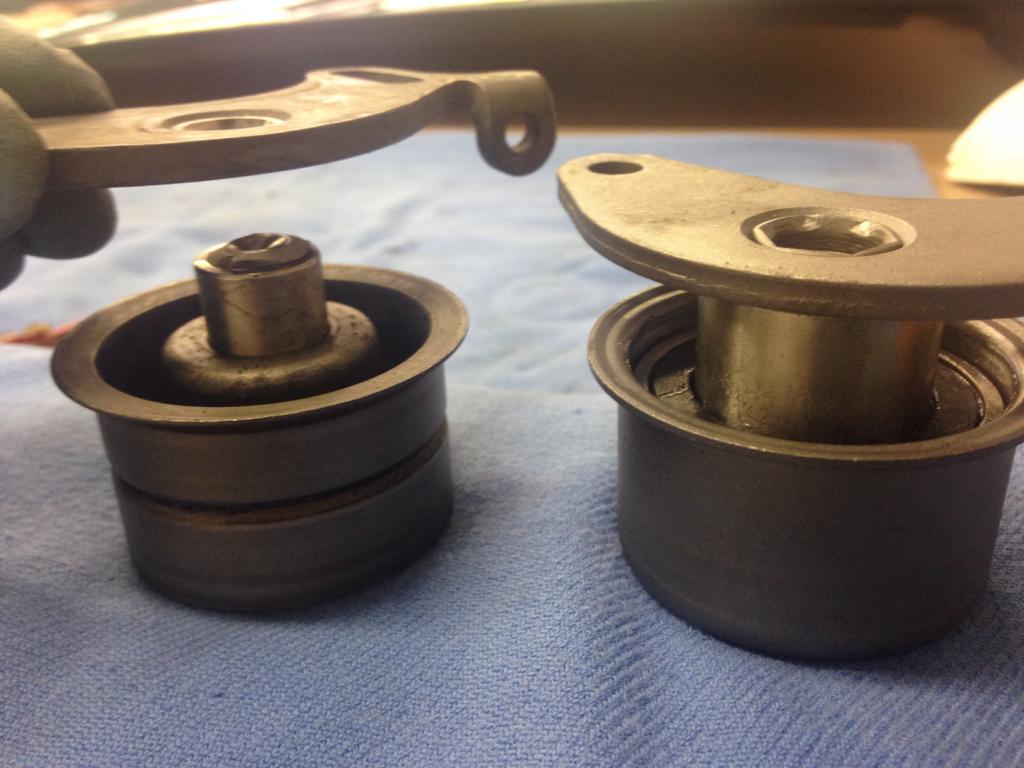

          Well This might not be the place to ask but I just had a Gates tensioner and it snapped right at the base of the pulley where it meets the backing plate that bolts it to the motor. What gives?!? I thought gates was a good brand?
          Anyways what brand pulley do you guys think is the best quality?

                          We always reccomend using bmw OEM tensioners for this exact reason. Aftermarket ones fail like that by pulling away from the backing plate. We weld any aftermarket tensioners we have to use to avoid that problem.

                            This would have been good to know a few months back :roll:

                              Btw here is the carnage of a bad tensioner and what a nice quality one looks like next to it.
