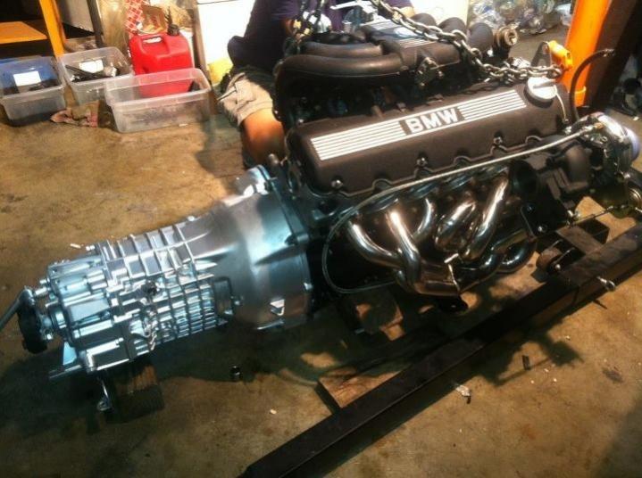

    Hey guys, new to this forum. Wanted to see if I could get some opinions from people on the forum about Ems options.
    It's a 87' 325 with a M20. Fresh full engine build with forged internals cometic gaskets arp studs etc. Hx35 turbo. I Need injectors (looking into 42lb Bosch injectors) and a ems. Ive been advised to purchase the miller war turbo kit but I'm hesitant due to some of the reviews online. HP goals are 400whp on e85.
    Budget is $2k for ems and injectors
    If anyone's got some friendly advice, that would be great.
    Thanks guys! :)
    Pic is with old turbo for test fitting
