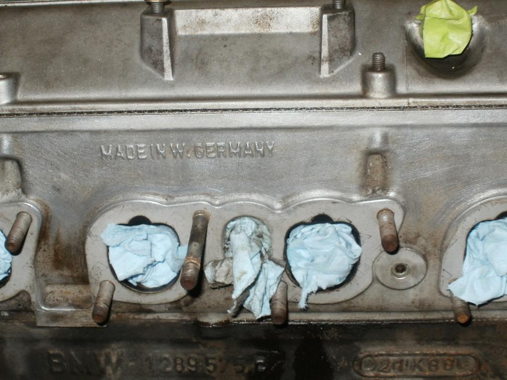

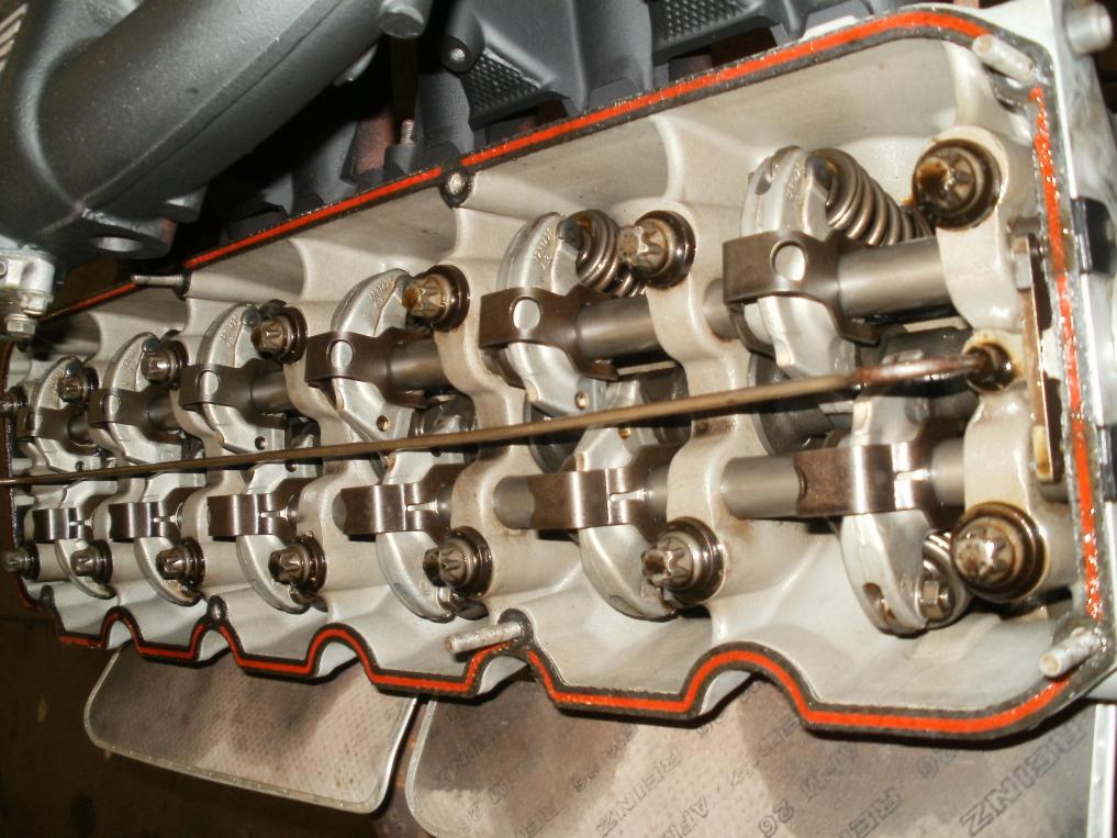

      This is the 731 head i'm running and pretty happy with. I always wondered what the circle cutout on the middle intake gasket was for on 885 heads, now i know.
