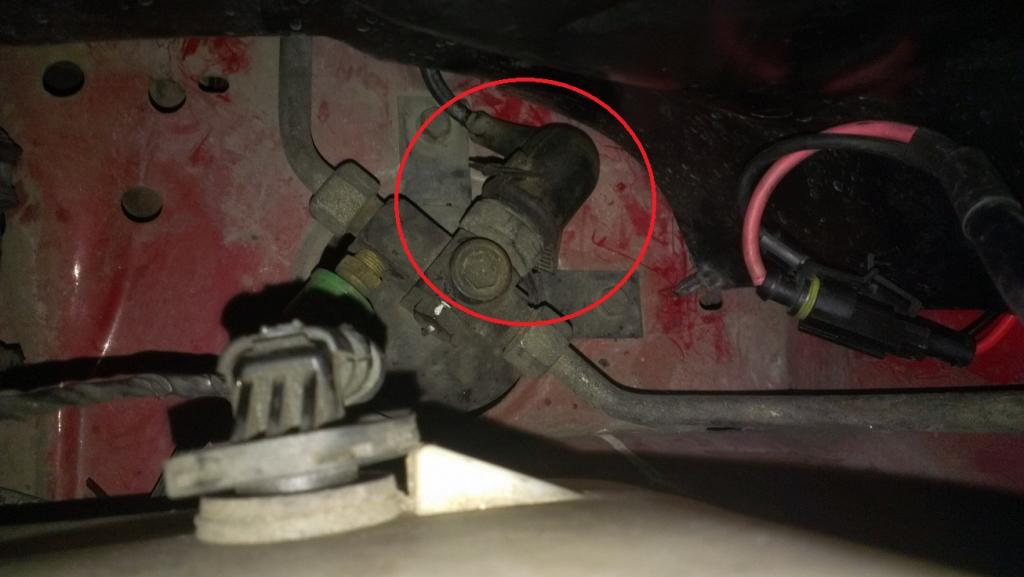

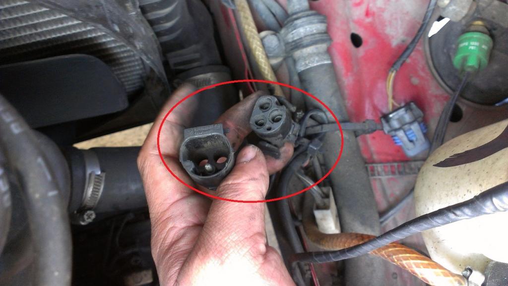

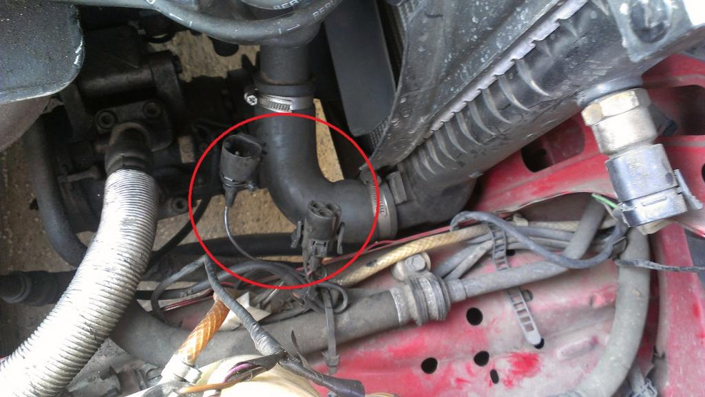

The first and sec pic are the compressor leads. If your not using a/c id reunplug it (is that a word haha). Same for third pic which is the a/c pressure switch.Comment
