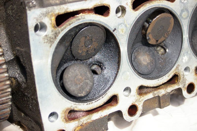

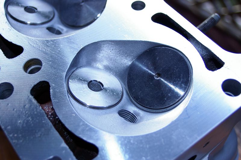

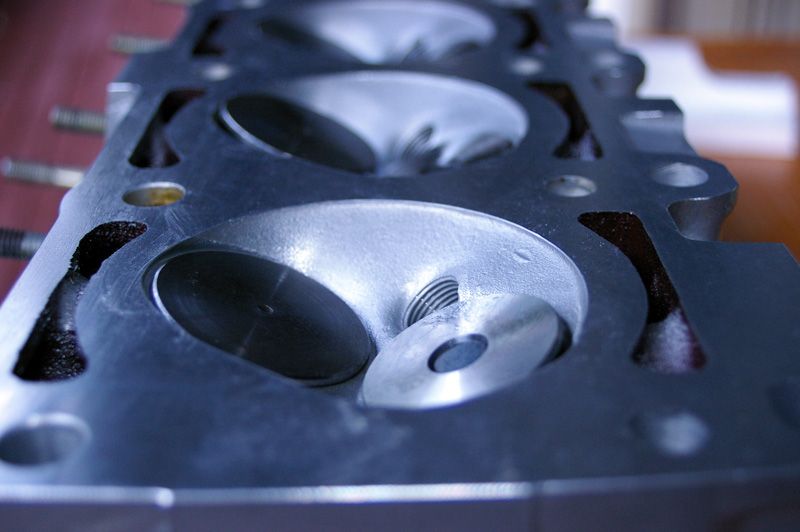

                              Hartge used the 731 heads on H23's when they built 2.6L motors, but they modified the head a HUGE amount to fit the larger valves, not just the pistons. When you look at the closed chamber shape of the 731 head you can see it needed modification to fit the domed style pistons the 325i used too.
                              Modified chamber of the 731 looked a lot like this.
                              Compare it with the shape of the stock 731 head
                              Quite a bit different and a lot of material has been removed.
                              For each full point increase in compression ratio, the added power developed is roughly 3-4%, until you get above 12:1 then it's reduced even further. Obviously camshafts make a difference, but all things remaining the same, the increase in comp ratio doesn't result in massive gains in power by itself. As Digger said, you need to take advantage of a whole host of other things to take advantage of it. It kinda sounds like you are trying to do it on a budget, so you are better to stick with known combinations that work.
