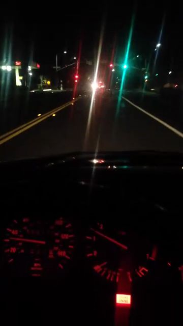

m20b25 cut out video

My car also does this, not all of the time.
Not sure what to testComment
Your video of the event isn't helpful. If it had stayed on the cluster during the event that might have provided a clue.
If the tachometer takes a big drop when the cutout occurs, the DME is loosing timing data from the engine. That can be a bad CPS, bad engine harness , or bad DME. If the tachometer doesn't react, but the econometer drives toward zero, there is a fuel delivery problem.The car makes it possible, but the driver makes it happen.
