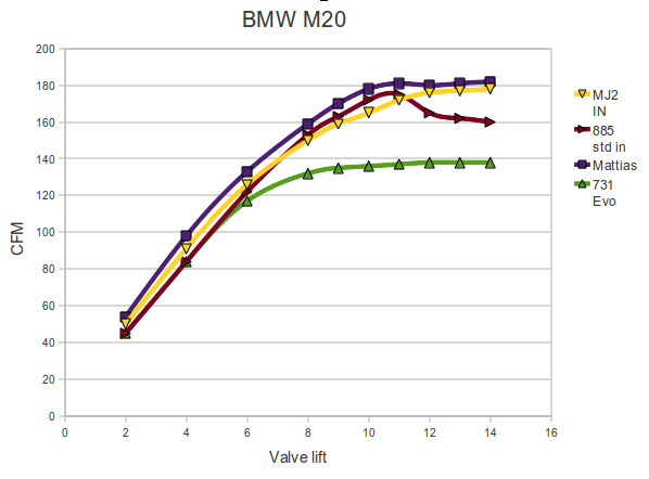

        The m20 head flows pretty well from what I understand, but some mild work can still yield some ok but not great flow increase results. Bigger valve sizes and lift are limited due to cyl clearance but +1 works, and apparently one of the bigger restrictions is the intake manifold itself, not the head. If you go over 2.8 liters the stock intake manifold may be holding you back more than the head itself, hence why many build custom and itb units. This would apply to turbo flows as well and even more from the exhaust/header side.
        "this head was done to suit class rules that dictate stock 325i camshaft"
        Also read through this whole thread: http://www.e30tech.com/forum/showthread.php?t=75938
        and (one of) the money shot:
        I'm now up at 182-183 cfm @ 14 mm lift with a pretty calm port and nice average flow speeds (260-270 fps). The flow is 5-10 cfm lower at high lifts with the intake mounted and the reason is simple, it's too small. I have a few options to improve things from here and I haven't decided which way to go yet. (Mickes flow in yellow)
        The flow achieved with Micke's head was with 43 mm (+1 mm) valves. You can see how my port flows better overall but slightly stalls up top, not much happens after 11 mm lift. If I raise the port or somehow make a better inner radius I could probably get up top 190 cfm but it's just not feasable right now.
        Old:
        vs new (notice the eleptical cutout so the +2mm valve actually fits in the cyl head):
        Apparently that work was based on a Hartge 2.3l head.
        TL;DR Gasket match your intake manifold. Clean up but dont remove much or any material from the cyl head intake/exhaust and add +1 valves with a turbo cam (not lots of overlap like NA cams). Any more than that and you probably want the flow bench. You are not using a log turbo manifold, are you?
