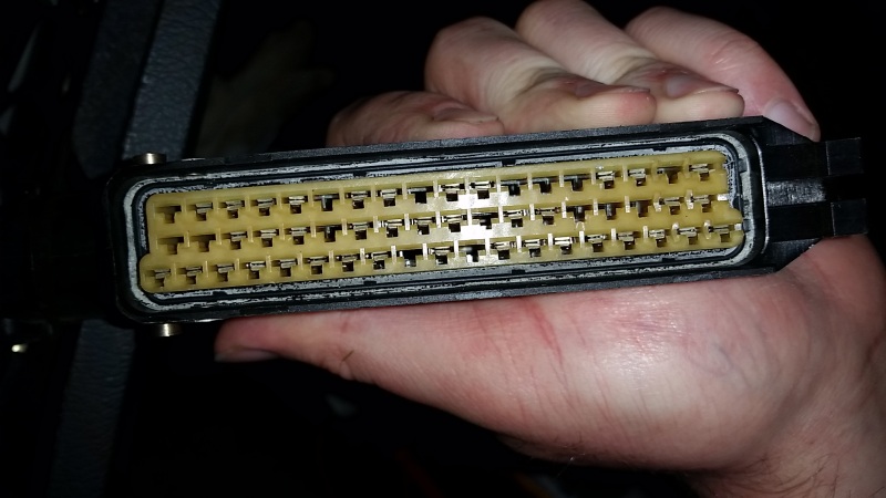

While trying to diagnose a problem with rough idle I decided to perform some electrical tests to check my ICV and AFM. Checking the AFM involves measuring resistance between pins 7 and 9 on the ECU connector (according to my bentley manual)... problem is there is no contact present on pin 9.
Has anyone seen this before? How do I perform an electrical test on the AFM?
