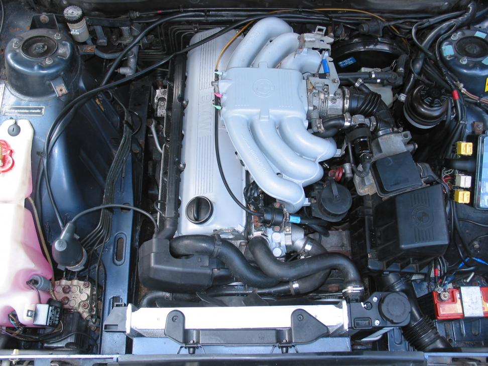

                Heres a picture of my engine tweaked as described above.

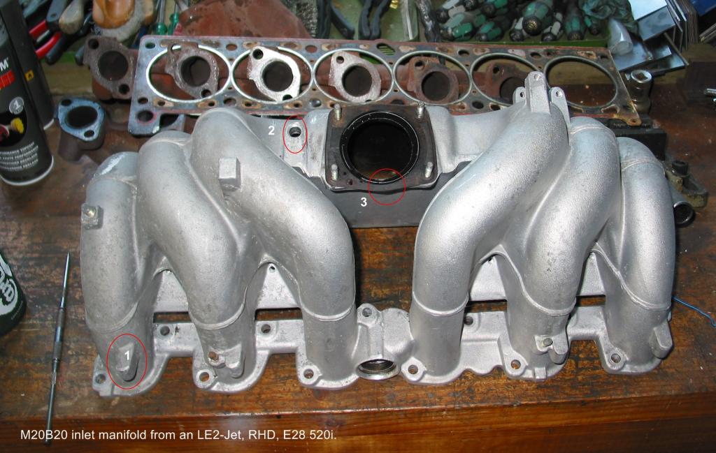

                  There are a couple of points that may cause problems using the M20B20 inlet.
                  In the photo below;
                  1. the knub circled needs to be removed as it interferes with the fit of the metal pipe/cable carrier,
                  2. this hole is where the brake servo vacuum pipe was fitted needs a plug. It actually has a spiggot here that has already removed.

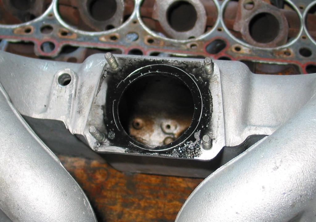

                  3. When you open up the throttle body flange it can get very narrow. See the bottom pic for more detail. This may be a good place to build up the flange with JB Weld, otherwise Jim Levie will be telling you to get a smoke test done.
