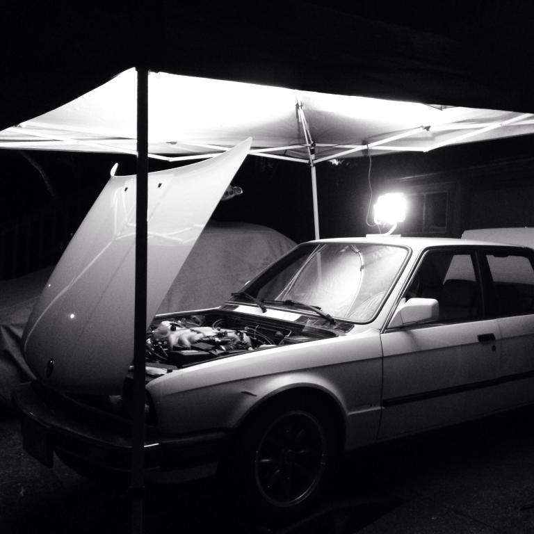

        Thanks for the advice. Last night I decided to just pull the head to be on the safe side. Glad I did; there is oil seeping from the front of the engine at the head gasket. Probably just a mater of time before I have another issue. Man I wish I had a garage.
