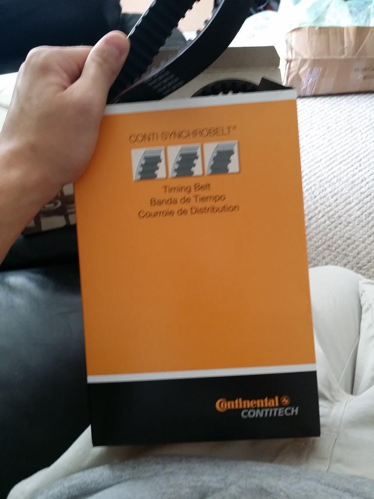

    Is it a contitech belt like in the picture?

      Yes its a contitech belt. Im not sure im not at my house right now but i will let you know

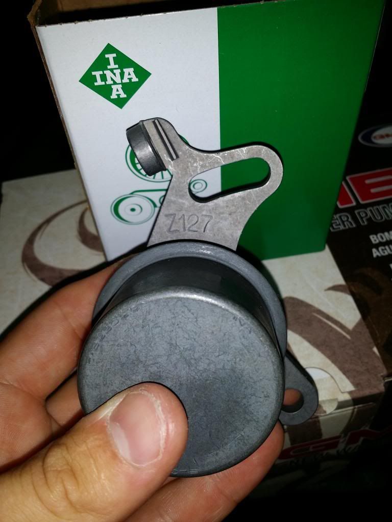

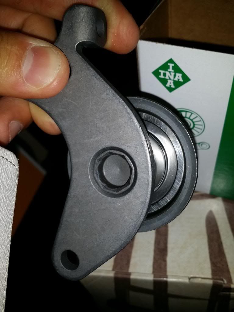

          tensioner supposed to be capped off? havent seen the tensioner like that before

            Some are capped off and some arent
            • nando
              • 34847
              the tensioners that look like that I've seen fail. the shaft of the tensioner is pressed into the bracket and it shears off.

                    The tensioner in that kit looks like the failed one in this thread,

                      The tensioner has z 127 stamped on it though.

                        I actually think that kit is cheap for the amount of parts it contains. perhaps a bit too cheap - waterpumps are what, $65 these days? a conti timing belt kit is like $40-45. plus it has gaskets, a t-stat, the spring, etc. plus free shipping. they had to skimp somewhere to make a profit.
                        the pictured one does. but you don't know what you're going to get. it's a random ebay vendor - we don't know that the parts are poor quality but there's no way to know what they will send you. plus I don't think a stamp means much, it's not difficult to copy. if you go with a known reputable vendor at least you'll know where the parts came from and what to expect.

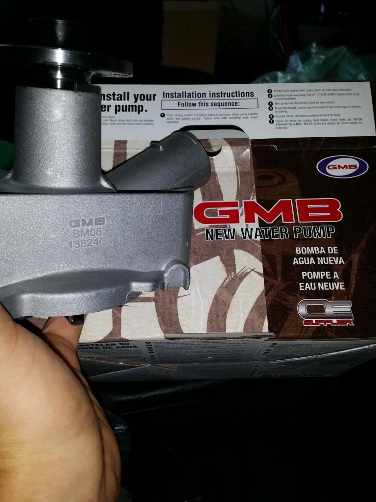

                          Ok guys I updated with pictures. The water pump is made in China. Everything else seems legit.
                          • nando
                            • 34847
                            I would shop elsewhere unless you're scraping for 20 bucks.

                              Well I'm pretty sure all the parts are reliable beside the water pump
