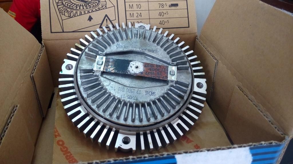

                    • Raja_Mongkut
                      • Aug 2012
                      • 75
                      Originally posted by SmokeE30
                      we never got them here either but they are only 60-70$ for the blade from bmw and they fit on stock or a bunch of other bmw fan clutches so its still a pretty cheap option for getting good cooling in a tight space without expensive aftermarket slim electric setups.
                      if bmw stuff isnt really available i think an electric fan swap is probably your easiest choice though where are you from anyway?
                      Sorry for the lack of updates, I'm from Malaysia by the way. Managed to find a humane dealer who had it for $65. Will stick with this for the time being before I contemplate an electric fan swap.
