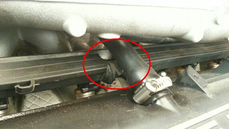

    I bought this car with work done I'm trying to reverse engineer. Someone put in 19lb injectors. 2 questions.
    1. My fuel rail does not have an outlet at the end opposite of the fpr. I noticed a stock one does. What is it for and why don't I have one?
    2. My electrical harness seems to have been cut and taped off, maybe to fit the breather tube? Is this normal when putting in 19lb injectors? See pic.

    fyi I'm trying to track down a lean issue. Fuel pump, filter, regulator, ecu all check out.

    I need to look in to mine, that a late model correct?
    All the 19lb installs I've done (quite a few) its a simple unbolt everything and just swap injectors and that's all.

      Yes it's a late model 1990 built in1989. I figured it was a simple swap so I may pull the harness, rail, and injectors and start over. Just confirm for me if you could.

        Can you take a pic of the fpr? And yeah looked at mine, there should be no break in the harness rail other than 2 places. One in between cyl 3&4 and on the end toward cyl1.

          Yup, can be done in under 45min, have some silicone grease handy to slip the new injectors in with. Just a very small amount on each O ring is enough. It's possible with out it, but makes things much faster to get back together.

            1: the fuel feed line just changed positions on the late style rails either style rail works as long as your hoses reach.
            2. somebody may have broken the plastic cover trying to remove it before and just taped it up?

              it looks like they cut it around the vac hose on the valve cover. wow.
              the whole thing comes out pretty easy, just pry up on the harness and it'll pop off the injectors. it disconnects via a round connector under the throttle, then you can inspect the wires and replace it if necessary.
              oh and use a flathead screwdriver to remove the hose first. lol. some meathead couldn't figure that out apparently..

                Perfect thanks guys. I found this article too, looks like no breaks in the harness at all. I'm not even going to inspect the wires, just going to replace it. While I have the injectors out I'll get those cleaned too. Saw someone on here that does it cheap :)
                Meathead for sure. I have taken off that valve cover breather tube before to replace the valve cover gasket not a big deal.
