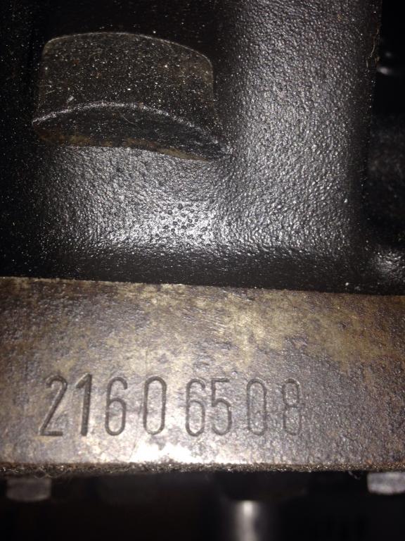

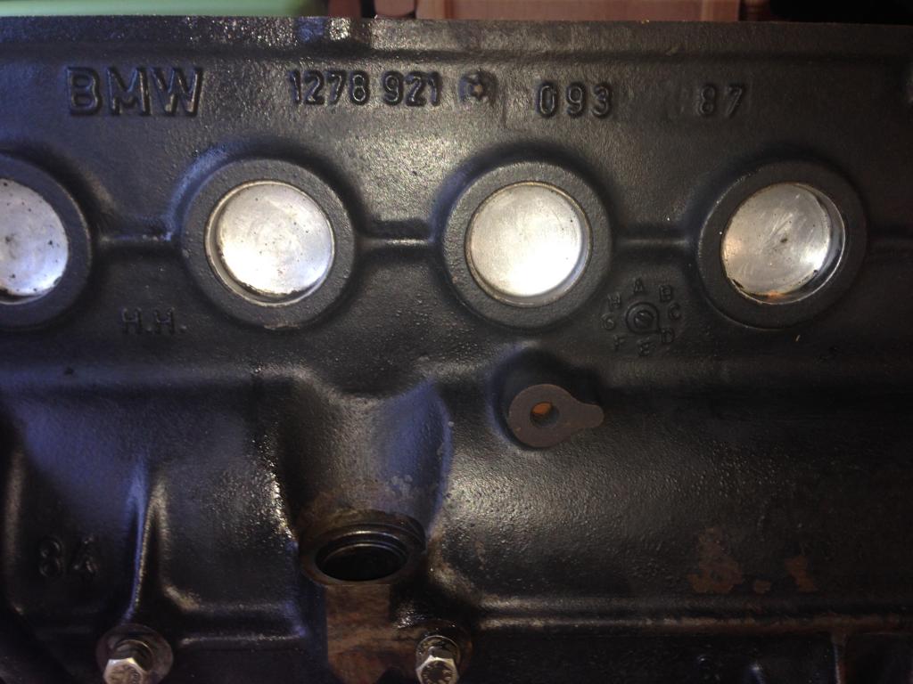

    Hi, I have what I believe to be an m20 block, I can't seem to find any of the part numbers in the engine identification documents. Can anyone identify this engine for me,
    Thanks

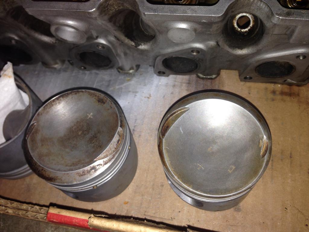

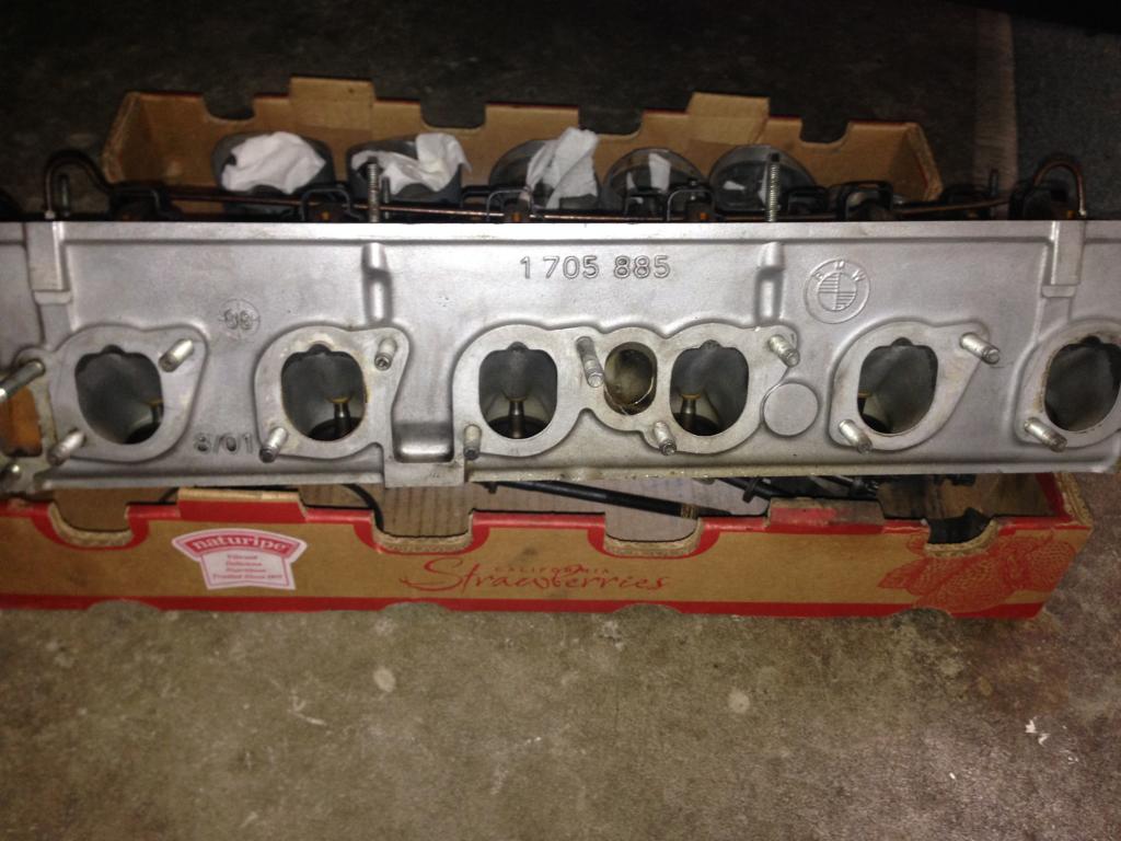

    Here is a pic of the pistons and the head, i believe the block is 84mm bore. I got the spare block and head during purchase of the car, I'm using them for an engine rebuild, but I noticed there were some differences in the spare block. The car is an '89 325i.

      Yep, looks i/is to me, too. OUCH for the exhaust valve and that piston on the right, tho...

        That's an i head in the last picture. I'm almost positive you have an M20, but not sure which variation.

            ya those pistons/rods were from a 1991 mtech2 vert.
            im wondering if you somehow got a super eta crank or something.
            I do have eta rods, i would need to pull them from the motor. tho. but you would need the super eta pistons.

              Ya I think it's an 81mm crank, I'll take it out after school and measure it.
              I have the super eta pistons, at least I think that's what they are. Just trying to figure out what is the best option for performance since I have the longer throw crank.
