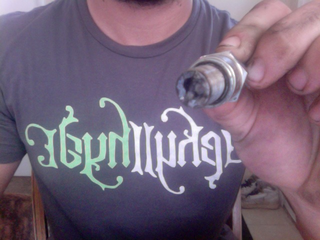

okay i have an update for you. i just went out and tried to work on it some more. i pulled a couple of the plugs but they were not wet with gas or anything so i put them back in and tried to start it. it turned over and acted like it was about to start then it just locked up...Comment
The picture isn't good enough to say whether the plug is burned, which would be caused by very lean operation, or mechanical damage, which would be caused by the cam jumping timing.The car makes it possible, but the driver makes it happen.

alright... so now with the plug being crushed im looking at my piston being messed up from hitting it?Comment
