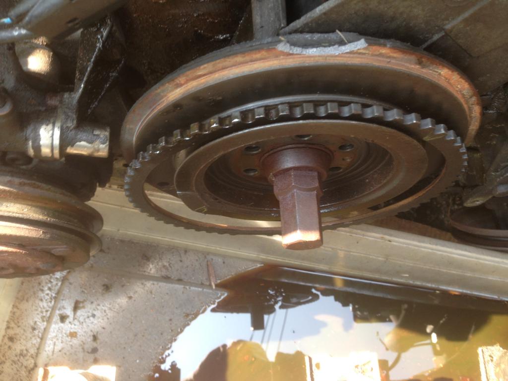

    Trying to do a water pump and timing belt change.
    I can't believe this, but my pulley puller snapped the crankshaft pulley, not once, but twice.
    So much for it just pulling off..... :shock:
    HOW DO I GET THIS OFF??

    Most take some PB blaster and let soak for a bit. The take a hard rubber mallet and give it a thunk towards the engine which breaks the grim and being stuck then they just kind of wobble em off.
      Already did this.
      I think I may have a "two piece crankshaft" as Bentley describes it.
      I tried the starter trick, to no avail.

        It's a tight fit but you don't have to remove the crank hub to change the timing belt, just the 6 13mm bolts and the pulley.
          he's removed them already as seen in picture.

            Found a pulley an hour away. Going to get it now.
            I still have no idea how to get the old one off.

              Never tried using the tool,all have done them the way I have described, Anybody else have another method?

                On my way back with pulley.
                Since old pulley is fubar'ed hopefully a bfh will get it off.
                Been soaking with pb since the start. For about 18 hrs now. 5 or 6 times.

                  Bigger hammer did the trick.
                  Thanks guys!
